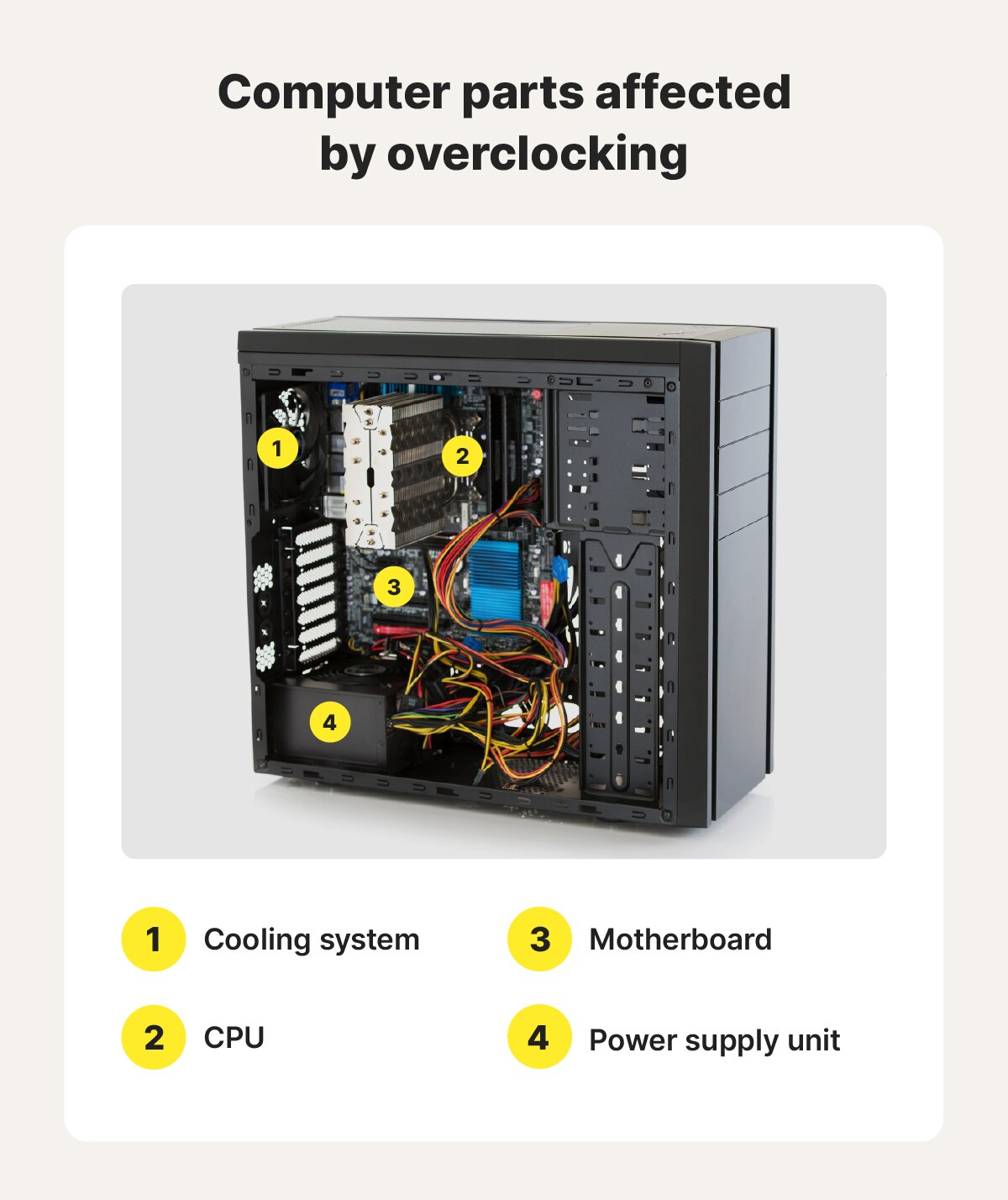

1. Verify your system’s overclocking support
First, you need to check that your computer’s hardware can handle overclocking. This means confirming that your CPU, motherboard, cooling system, and power supply unit are all equipped to handle this performance-intensive task.
Here are the hardware details you’ll need to verify:
- Intel CPUs: Only Intel processors with a K or X suffix (e.g., Intel Core i9-14900K) support overclocking.
- AMD CPUs: Most modern AMD processors support overclocking, and many include Ryzen Master software, which makes overclocking more user-friendly.
- Intel motherboards: X- and Z-series motherboards support full CPU overclocking, while the mid-range and B- and H-series motherboards typically limit overclocking to memory (RAM) only.
- AMD motherboards: B- and X-series AMD motherboards support CPU overclocking, while A-series motherboards generally don’t.
- Cooling system: Gaming PCs often come with enhanced cooling setups that are suitable for overclocking. These include high-performance air coolers, all-in-one liquid coolers, or custom loops. Budget systems with stock coolers may require an upgrade to avoid overheating.
- Power supply unit (PSU): Use a quality PSU from a reputable brand with adequate wattage. Overclocking usually requires a minimum of 500–600 watts, depending on your CPU.
